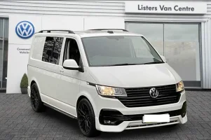

They’ve offered to replace it with a standard grille, but the van has quite a bit of black styling already fitted - Leighton rear bumper/spoiler, black side bars, matte black grille etc - so swapping it out would spoil the overall look a bit (picture below).
