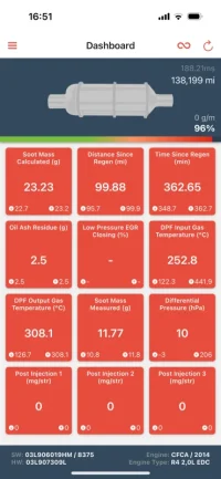

I'm new to Carista, just checked DPF info. Soot 10.3 grams, time since 0 hr, Distance since last 13 km. Not sure what soot it should be. Is there anything else I can check?

I use an app on iPhone now called DPF Monitor for VAG, its really good
The top image even shows you when the regens are happening. Its all about to kick off now at 97% :)

Got it working with the Carista, reinstalled and it woke up. What do you recon on the results? Oil ash as a value was 111.05g.
if your dpf is already at 24g soot after 3.4 miles since the last regen I reckon that's well and trully blocked and it'll try to regen again straight away... this is what my one did before the turbo went, the increased back pressure of the blocked dpf puts too much load on the turbo shaft which will break.
