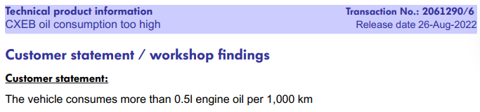

Surprised they aren’t replacing dpf / cat as consequential damage items.
Yes !!!! Thank you @mmi
That’s the kind of argument I was hoping to find.
Is this from erWin or Elsa ? I couldn’t find it in the download section.
It's from erWin - I believe it's found under Vehicle-specific information - by entering VIN you'll get items dedicated to the VIN. Of course need to purchase the access. An hour about 9€ - plenty of time to also load other T6 relevant documents.
