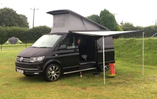

My tyres are huge (2.75/40/ZR20 106 W XL) not all 20” are though.
and so generate a little more road noise especially over those motorway concrete motorway surfaces with drain away lines cut in.
They do touch the wheel inner on full lock but really only just, and taking a tiny smidgeon off the steering cures that.
- personally I love them and it’s a small price to pay for the aesthetics
