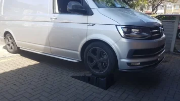

Bloody Nora... don’t let @Tourershine see those wheels in that condition :mad:
I'm awaiting my new t32 204 swb DSG in indium grey......
I want to swap Devonports...
I don't want 20" as I don't want a hard ride (work vehicle) so left with the choice of 18" or 17".
If I go for 17" I can use existing tyres. Is it worth taking the plunge and going for 18" bearing in mind I'll keep the van for a while?
IMO it depends on the height of your suspension and having the same ratio of wheel arch gap to tyre wall so it looks balanced.
I spotted them the other day on a different thread but refrained from saying anything :eek:
Lol..
Sorry guys..
It's a work van mon-fri .... so sometimes it gets a battering.
I'll try my best this week end.

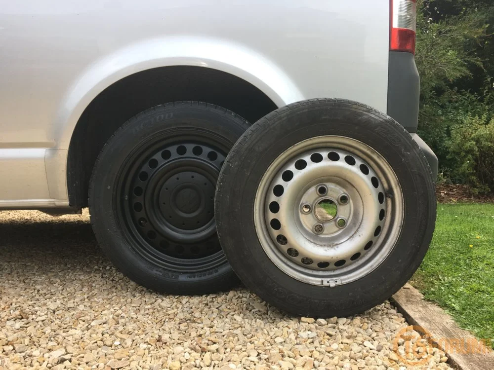

Just get some 18’ steelys and powder coat them satin black. Boom!
They ride like a charm too, reduced the ‘bouncy’ ride of the 16’s but then the tyre is 10% lower profile so to be expected, but in no way is the ride hard/stiff - it just feels hunkered down. And they look badass (but I’m bias haha)
I like this idea!
