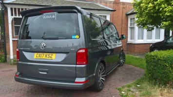

These ones?. :whistle:
Oh dear oh dear, not again.
