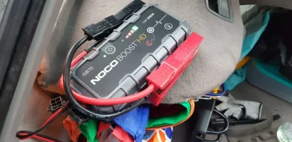

Gota love a NOCO Boost pack + Chargers . . . .

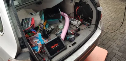

here we see a NOCO GB70 powering the MAXISYS Diag Scanner . . .
heres the scanner . . .

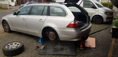

which is being used on our BMW E61 as the Air suspension had collapsed . . . . .

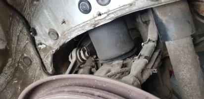

were using all the kit to replace the air-spring . . . . (new one fitted , below)

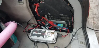

and finally, the NOCO GB1500 charger running as a Power supply and charger to keep the cars electrical system alive (Air ride on this BMW is 12v air pump etc )
Sorry Victron . . . . . . . . . Today NOCO gets the Prize. . . . . =]
and FYI - Car and driver happy . . .
Air Ride system bled down,
old leaking airspring removed,
new airspring installed.
system pressurized,
level control system tested.
Car put back together . . . .
Charger left on for a few extra hours . . .
Road test complete - Car and driver happy and doing well.
