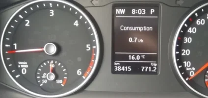

DPF regen active - engine idling.

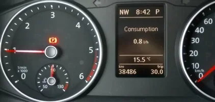

No active regen - engine idling
