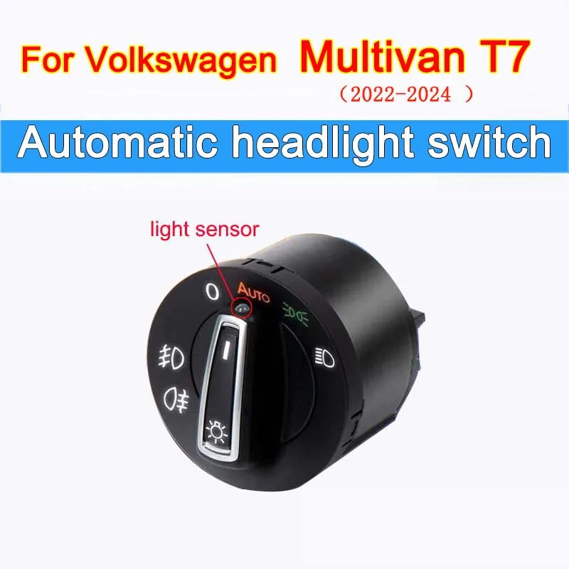

I fitted an auto light switch for a T7 multi van today bought from Aliexpress and it works well with no error codes my van is a 2021 T6.1,
this was posted by @JustGllenn a week or so ago and I was sceptical about it but it does work well.
That's quick delivery !
Got to say, all my purchases from aliexpress have been spot on
Well, I've gotta get one of those then, thanks John! Just pull the old one out and pop the new one in? Should work with retrofitted fogs do you reckon?
Just check the rear of your original light switch to see that it matches the one advertised as there are two types originally.

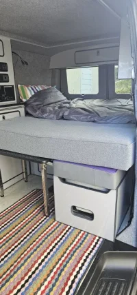

I could never understand why a nameless professional outfit would mount power management in the wardrobe when the said equipment had a 'gets hot' warning. Offending Sargent Ec155 was removed.
Electronics have now found their final resting home after much experimention:
304Amph ecodrift mounted in dead space under the wardrobe with adequate ventilation together with its AC charger.
Two switchable MPPTs mounted umder the grill cupboard and
The MPPT switchover, AC Consumer unit and B2B in dead space in the Rib bed
