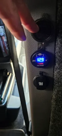

Moved 12v socket from behind the drivers seat (floor level and perfect for kicking!). Now up on B Pillar behind the driver seat, took the oppertunity to add USB outlet with the unplanned benefit of voltage display for leisure battery it's fed from. Also added storage net to side panel.
