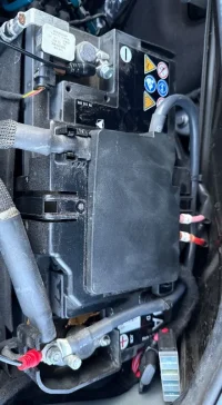

Also, when I got the van from new I had an after market towbar fitted when the electric tailgate was installed and they fitted the power direct to the negative terminal which I know isn’t best practice. The cables could have been dressed a little better too (annoyingly I never took a ‘before’ photo). Whilst installed the MPPT cable to the battery I tidied the cabling and terminated the positives to the top fuse holder and the negatives to the side of the van, scratching the paint underneath and checking the resistance. It was 3.4 Ohms before I removed the bolt and 0.6 Ohms (the same as the short neg cable to the chassis of the van so could be my meter leads) after so proves the paint does need to be removed.
The BM2 is just temporary at the moment whilst I work out if I’m going to keep it:
