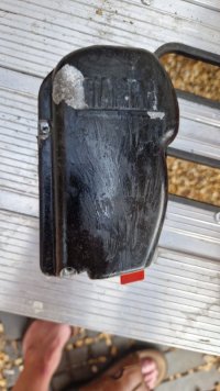

Well that was a fun little job replacing the left hand cap on the Fiamma F45s!
2 out of 3 screws seized solid, bought a screw extractor selection box, crap!
Drill out the screw caps with a selection of hss bits, gently prize off the old cap.
A pair of small mole grips was sufficient to remove the remaining screw Stubbs.
Unlike @moomin-j ,I didn't have an available 17 year old to support the awning roll, but 'top tip' here is to extend the Fiamma all the way and on full leg height, before you begin. There's nowhere for the empty roll to go then.
I used copaslip (because I had it), but there is an alu slip product which I didn't get.
End result, good for another 4 years.

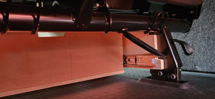

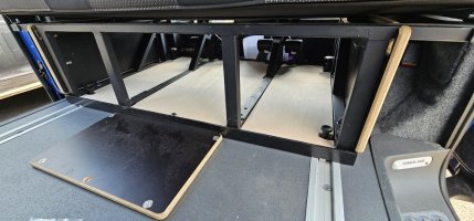

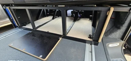

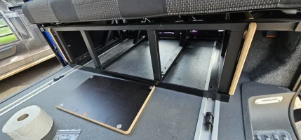

First tests before drawer has been glued, carpeted etc...
Unfortunately need to take it out and modify a bit.
Need to also find and fit some latch, locker or so ...
That's interesting! Are the slide rails mounted to the seat legs or to another 'box' it slides into?
I've just got a plastic box there and that looks really neat!
There are two side panels (it gives massive flexibility with slide rails location) made of plywood 18mm (drawer 12mm).
Because of tests purposes fitter with just single bolt atm to seat legs.
It still requires some shape correction (at least to get some better access to seat mechanisms) and have to shorten a bit drawer as can't close it.

I have a Caravelle Executive with sliding bench seat. It has3 little plastic removable doors from new and internal runners inside the pockets. Only one that is the middle pocket has a tray that slides could not find any others even on line. The spaces are very convenient for tools or ropes and such. First the little plastic removable doors started to flex and then not remain shut followed by the only sliding tray provided edges snapped and so no sliding tray. No longer use the space because not suitable for heavier gear as acceleration and braking forces cause the small cargo areas to burst forth with stashed goods or just sliding the seats back and forth does the same. I very much like your efforts of utilising the under seat storage capability as so little effort has been provided by the manufacturer to provide space for even the most small amount of everyday equipment such as tyre pumps wheel braces or spanners and all the self maintenance gear one might carry in even the smallest of cars. I have resorted to carrying stuff in small crates that just get in the way weather in the boot or the passenger space and then their is the safety aspect of securing down, not always done properly. So stout stable draws on runners such as yours is a very excellent and worthwhile project! perhaps i aught to consider doing something similar for the Caravelle Exec it would make life far more comfortable! :D :)
Absolutely love that - might have to steal the idea!!
:thumbsup: Thanks bud - happy to hear that. Please feel free - there are no copyrights ;)
Glad you have been inspired by that drawer :grin bounce:
What I can suggest is please ensure the plywood boards are straight. Didn't notice before mine ones were arched which makes difficulties later on 😳
Thank you so much for your kind words! :thumbsup:
Yea, that's the shame there is nothing (at least I didn't find anything) on the market. A few days ago I was carrying a small shopping bag behind the seat. Despite the gentle driving everything was "flying" around in the car. 😡 That was already enough for me 🥴
