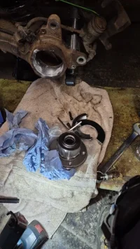

Two new rear bearings, cheap eBay pullers worked ok not perfect came out easy, going back in kept pulling off line all the time, first one took a while to find a method then found if you wind in slowly gently tapping edge of hub just to keep straight with plastic face hammer it would go in perfect quite quickly then just wind in until it stops and don't forget to clean well with wire brush front and back with a little grease to help it in, I was expecting a nightmare after a bad run of jobs on the household fleet of vehicles but this wasn't to bad van has done 151k miles, my list of todo jobs just got shorter
