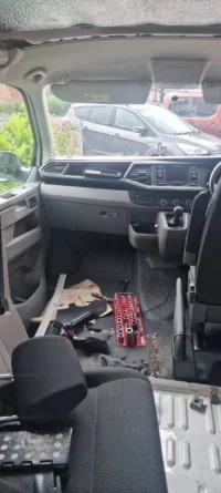

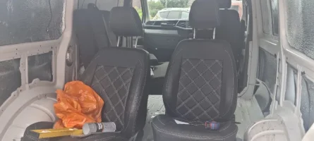

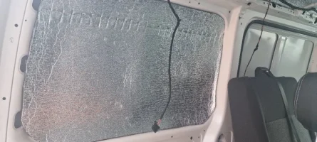

Removed seats and mat could not be ass to remove middle section work a round then lie down silent coat and dodo lining and lastly positive wire for dc dc charger to driver seat, cut hole for coming back air for night heater on driver step as tomorrow will instal night heater under but not sure where cut hole for incoming heat yet as need check under as there some wire ?.? Without lifting that beast no way to see.
Tomorrow as well want fix underslug water tank 69l wonder in 2h will be enough on ramp.
Next step today to put all back sort a bit wiring and fit swivel adaptors (yes Lee I didn’t even open them yet😅)

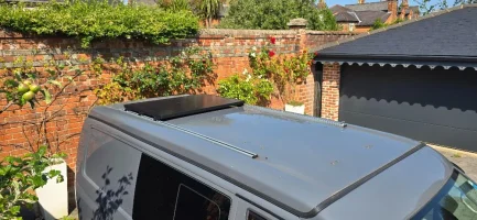

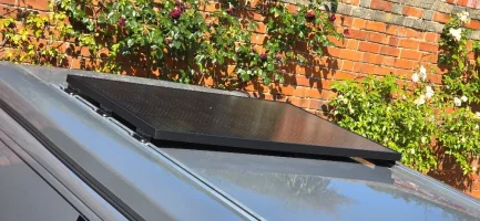

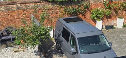

So took the plunge and ordered a relatively cheap solar panel from Amazon (150W, £85) and installed it this morning in about 60 minutes. I chose this one purely because it will fit between the already-installed T-tracks in my Reimo poptop (with a bit of extra drilling, obvs), and the length was a decent fit for the gap between the two T-tracks.
So far quite pleased with it. It's relatively light (just over 8kg), Current rating is Imax=8.2A, and even with a very cheap and nasty Chinese no-brand PWM it's delivering 5.9A to the Clayton LPS in the 10AM morning sunshine in Reading, flat on the poptop roof and not in full sun.
It also means I can take it off for the winter if needed and can move it up/down the tracks to accommodate a roof rack/box when needed. European tour next week will test it properly but at the moment it's enough to keep the beers cold for 24 hours👍

Very neat and tidy installation rails and solar panel, useful too. Room for another panel if you choose also. The small gap between panel and roof will help insulate the van from direct sun and might help in winter too. I like what you have done!
i guess that anything within reason could be run on the tracks so long as a bracket/runner is made up. Sat Dish, roof rack, awning mount, lamps, anything!
thanks, to be honest the hardest part was to find a panel that fit. I've haven't drilled through the roof yet, thought I'd wait till i've tried it out. And yes, if it works I'll add another panel. So far so good, it's delivering nearly 7 amps in this heat without even aligning it.

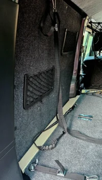

As jigsaw and router are my friends in last days :grin bounce: had to do something to prevent items from falling off the bed.
I made a filler between the bed and the van side panels. The current challenge is to fit the back (at the tailgate) of the newly created panels / filling to something stable (the filling stays in place when the bed is raised) without drilling the van body. I don't have a good idea I'd be happy for this yet. The natural candidate seems to be bed leg 🤔
Going to carpeting once all challenges (hopefully just brackets) completed.
Also finally fitted storage nets as already had screwdriver next to me 😉
