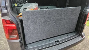

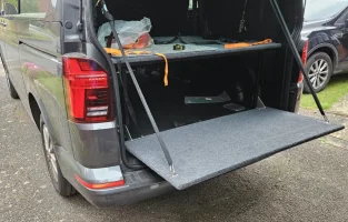

custom cargo /storage net brackets (net and bottom mount points don't exist yet ;) )
Original holes have been used. No drilling (top priority for me) at all.

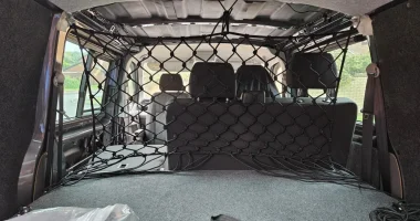

Second part of project "custom cargo net behind the second row of the seats" - not fully completed yet.
I don't have a good idea I would be happy with on how to hang the net from the ceiling without drilling.
The existing holes don't fit the standard dimensions of the rivet nuts (at least the ones I have). Ideas / suggestions are more than welcome.

Could you put a piece of aluminium attached at the top on each side?

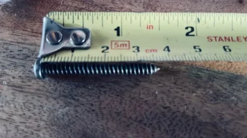

Bought a few different lengths, prior tp strip down, from these nice folk:
But after stripping down this was the length of the internal screw (sadly can't remember what size the other 2 were - sorry):
Good luck - hope all goes well....

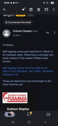

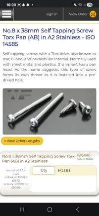

Just ordered 10 of the required screws for the F45s Fiamma end cap, All details attached, £7.49 delivered by RM.
Only need 3, plenty of time to lose the spares...
The newer recommendation has Torx head rather than the crosshead I now have to try to remove... joy!
