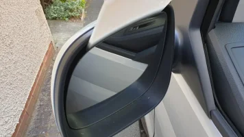

can you share how to get these off? i'd like to change ours but am not sure how to remove..!
First you need to remove the mirror glass. I angled the mirror glass all the way down and square to the top of the casing. Then levered it free with a large flat piece of nylon. Carefully remove the two wires from the heating elements and they're off!
Then release the three clips that sit directly behind where the mirror glass sat, toward the top of the mirror casing. I held these off their latches with plastic trim wedges (while I released the rest of the clips).
See Loz's post here for info on where the clips sit:
Mirror cap replacements
To release the rest of the mirror cover clips, I used a solid plastic wedge shaped trim tool and worked it along the gap between the two covers, starting at the outside edge and working in towards door. Take your time and the clips should survive!
