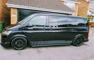

Busy + Brave I’d say.Removed the rear spoiler.
Not an easy job, but one made a little easier by the fact VW had drilled the holes, but not put any nuts on the threads.
Spoiler on...
Spoiler half way off. I used fishing line attached to wooden handles, and slowly worked my way through the sealer, using the block of wood to keep a little pressure as i'm cutting.
Spoiler removed, and the mess that VW had made installing it, talk about keying up the surface
Same surface after i'd wet flatted all VWs sanding, and machine polished.
Finally the van de-spoliered...
All part of the new changes, for when the new wheels arrive.

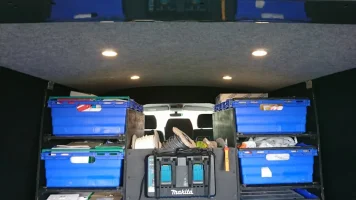

Both those things are brilliant. Where did you source the power for the LED light ?
Mine run off the timed courtesy light circuit so come on when you open the door off again when you close it.Both those things are brilliant. Where did you source the power for the LED light ?
CK cutters I see!!It must have been the weekend for it, I fitted leds into my Tailgate and work space yesterday. Did this to my last van and makes such a difference in winter when hunting for tools or working from the back of the van.
