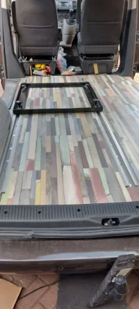

LOVING this floor...
Is it this by any chance:- Coloured Dimas Wood ??? As this is what I've got on my 'shopping list'!
If so what are your thoughts on laminate in a van? Some kind of vinyl seems to be the generally recommended route.
I'd just so love this in mine (when it arrives, sometime never at this rate.....)
It's made by Egger and called Seville rainbow oak. It's a 7mm laminate floor - was a bit tricky cutting to fit round floor rails. Chosen by wife and she's well happy!

Nice floor! A change from the standard Altro. Is that YoYo Glidemotion from Clearcut Conversions for the bed base? I’m planning to use this, so I’d be interested to understand what layers and thicknesses you built the floor with, how easy it is to slide and remove, and how much space you get when slid to each extreme.
Yes - it's a yo yo. With the runners accurately spaced and bolted down, the base slides relatively easily and locks off in 5 places.
The rails require 27mm. Clear cut provide 6mm packers to put in the dips in the floor, I then put 5mm insulation, 12mm ply, 3mm underlay and 7mm laminate.
Will post pics when bed installed but impressed so far!
Unless I'm missing something, the sub base you can see in my pic is not removeable once the rails are bolted down, but the bed frame can be unbolted from the base
