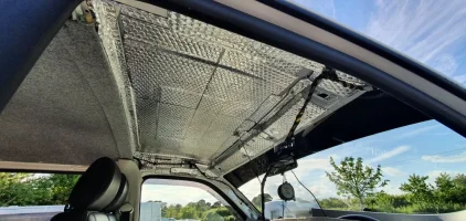

Worked a treat on mine, what do you think?
