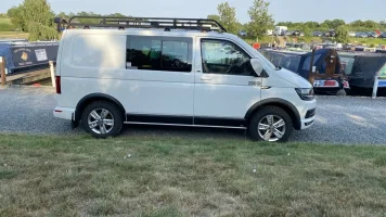

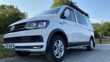

Mudflaps all on and sorted, can you believe i had one on for a month before i re-faffed and got them all on.
Now im a bit ocd.. well a lot
You’ll spot heli-tape behind area where they will scratch with vibration.
also the fronts arent The best fit...
extra screw beneath and ensure it sits clear of the door, plus they dont sit parallel so on one picture hopefully you can spot the black plastic spacer i put behind the inner most fixing... helps tremendously.
Look quite good now and semi happy with.. just need a clean up as been sat in garage too long
