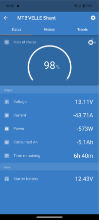

Another job off the list, finished fitting my 2000w inverter!
500w heat gun pulling 40 amps or so. The inverter pulls 1a on standby.
Also added a USB GPS to the Cerbo GX and ran an extra ethernet cable to where my touch 50 and 5g router will eventually live.

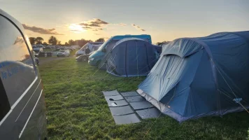

Well we actually have this as a means of Getting to the roof to setup the fold out solar panels for the weekend on the van roof...
But it's been too windy.... So we've deployed themmon the floor...
