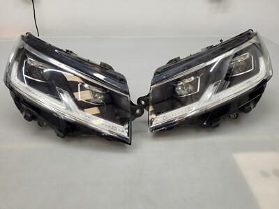

I have just took one of its not easy you need an oven to get the whole light in then warm up I cut it of in bits and then heat gun a bit at a time I just need a another light now to take lense of going to cut most of the new light up and then hopefully put it in oven when’s she’s out lolIf anyone can be bothered to change the lenses, there are some damaged T6.1 LED headlamps going cheap on eBay:
Transporter T6.1 LED headlamps ,damaged | eBay
<p dir="ltr" style="margin-top:0; margin-bottom:0;">Transporter T6.1 LED headlamps ,damaged.</p> <p dir="ltr" style="margin-top:0; margin-bottom:0;">The damage is cracks to the front lens, the rest of the lights are absolutely fine .The cracks were caused by tar and glue remover getting on to...www.ebay.co.uk

Hi Robert how you got on with the lights do you think a non led front glass will fit okThanks mate.
Purchased![]()
depending on what parts you will use (new or used). In the new ones you need to load the correct data sets (into the blocks for the headlights themselves and into address 55)Thanks, and one more question: i have a Launch CRP919X are you able to tell if I will perform the adaptation of the new lamps with it?
Hello, I’m from romania, I’m interested to buy +40722171843vw t6.1 headlights are fully controlled by Can. The only contact of the low beam headlights is used as emergency power (in the rays of Can damage).
to install vw t6.1 headlights on older cars, an adapter is required that can generate the correct messages in Can
I made this device and can provide a ready-made retrofit kit
