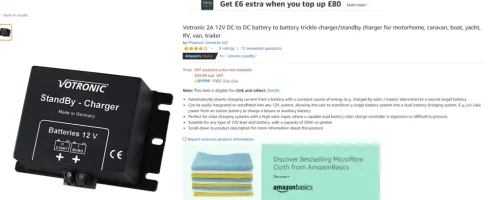

If your not Lithium you can use one of the Votonic Standby by trickle chargers . . . (to reverse charge the starter from the Aux battery regardless of charging method)
https://amzn.to/2RQZIxN
I'll probably go for the Votonic at least for now, as the Van battery is lead acid. Thats 4 charger's i'm up to now! (B2B, MPPT, 30A EHU, 2A trickle).
I'd contemplated one of these VOTRONIC - VBCS 30/20/250 that will do all of the above, but I quite like the idea that with separate chargers, a failed unit leaves 3 others still working.
