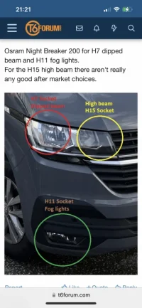

Hi, if you want it road legal:
Osram Night Breaker 200 for H7 dipped beam and H11 fog lights.
For the H15 high beam there aren't really any good after market choices.
That is the best simple picture ever thank you so much it makes sense
Trying to find that in the book is a nightmare
So just need a better H15 ?? Let’s see if anybody else jumps in to answer that but a massive thank you

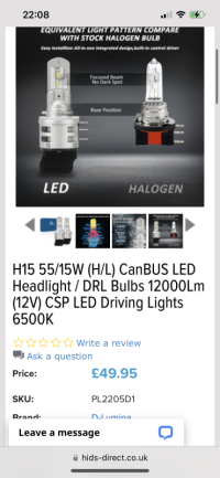

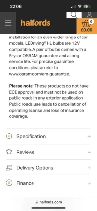

66DE6F64-2282-4633-9B3B-AACB06EE7AD1.pngB36B07BF-8532-4BB5-9F20-5120846BFAF6.pngDA503600-15EC-4B34-B95A-BBA66162636D.png
Found all these led type would these not work pls ? One from Halfords says not road legal is that right ? Cheers
LEDs in main beams are kind of OK because main beam will dazzle anyway. They are no different to the LED Lazer lights I have in my grille.
LEDs in dipped beam reflectors are a different story.

We’re are you using the h17s or do you mean h15 ?
Yep. Typo, H15s. Can’t find any LEDs to persuade me yet. Seems that halogen H15s don’t make much difference. Happy to be convinced.
