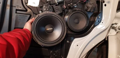

I bought ETON UG VW T6 F2.1 speakers upgrade, but as you can see from picture, Eton speakers diameter are way to big for T6.1.

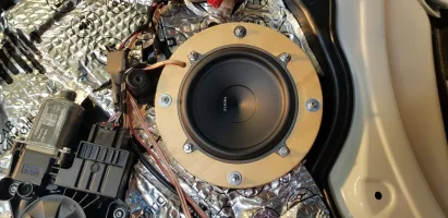

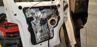

Anyway... I will install Eton on the back side, once the furniture is finished... I decided to mount Hertz MPK 130.3 PRO System with woofers, tweeters and crossover.
Eton is too big.. :(

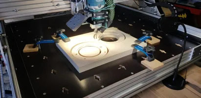

Hertz with modified holder

Starting with speakers replacement.
View attachment 75137View attachment 75138View attachment 75139
Bugger.. I've just sat through a 20 min video in German on how to fit these speakers... I presumed the t6.1 door was the same as the t6... thank god I found your post!
