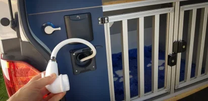

T6.1 4Motion Camper-Conversion to carry dogs

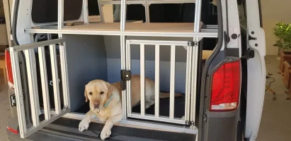

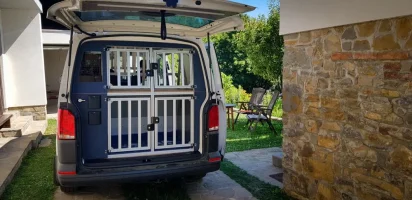

Won't it be pitch black in the dog crate when the tailgate is shut?
He is a rescue dog, he is used to the dark ;)
Anyway, when the dog is not working, it is the best for him to rest in quiet place.
I will install cooling fans on one side of the crate to move some cold air from the cabin to the crate.

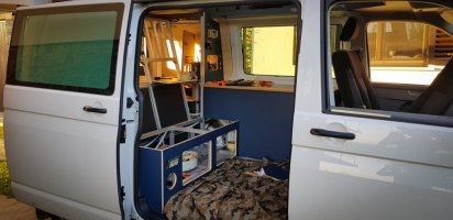

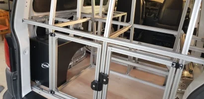

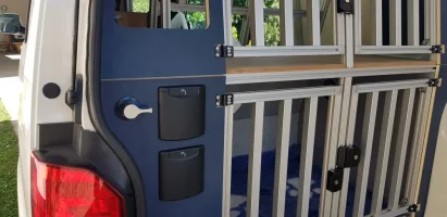

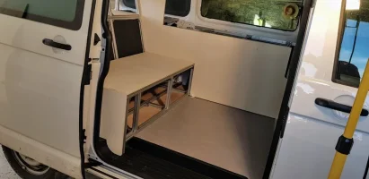

I'm thinking about building a frame for cabinets, dog kennel and bench from extruded aluminium profiles. 30x30mm profiles are lightweight and strong.
extruded alu frame / plywood furniture
View attachment 75258View attachment 75259
View attachment 75260View attachment 75261
View attachment 75262View attachment 75263

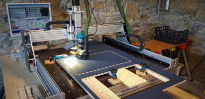

No need to build a polygonal 3D model for CNC cut. I just extracted some curves of van interier directly from the pointcloud (image01), measured the distances between the alu profiles (image02) and drew/closed the curves in Rhino3D.
You basically only need curves for CNC cut.

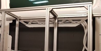

So my van is finally coming in march. Can you enlighten me how you attached the alu profil to the wall? From my understanding something needs to be done to get it square as the van is tilted at this point ?
I drilled soem holes and inserted bolts with nuts.... M6 if I remember..
Be careful, because the window is not in level with the floor!
Firstly mount the horizonal alu profile (below the windows) and leave bolts loose. When you mount the vertical alu profiles (from floor profiles to horizonal profile below the window) it will turn horizontal (loose) profile 90' exactly. Now you can tighten the screws. No need to shim.
