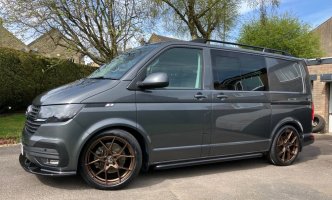

After a lot of help and advice (and parts!) from both Chris at the Van Cave and Steve at CRS Performance I finally got my act together and got everything fitted. I thought it would be right to say thank you to you both on this forum as it was on here that I first contacted each.
Velocity VF4 wheels 20x8.5" from the VanCave, with 255/40R20 Tyres all around, along with CRSs H&R Coilover and ARB kits, approx 65mm drop.
Looks great and drives SO much better than it ever did on the standard suspension.
