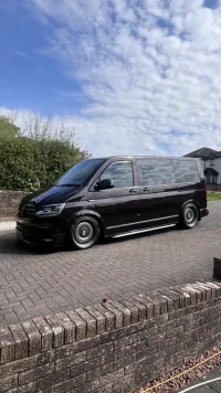

Michelin Latitude Cross is what I use 235/55/17 on a similarly lowered van. Although coilovers from CRS so the hitch height is correct as the attitude can be adjusted
This is on a downhill slope hence looking under inflated
