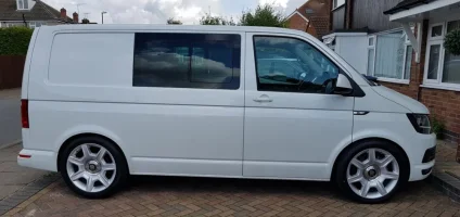

Folks, just in case anyone ever has their eye on any Vossen wheels, like the utterly gorgeous CVTs, I just had an email back from them today saying that all their 5x120 wheels are rated at 815kg. Bugger... :(
Vossen wheels are all 815kg

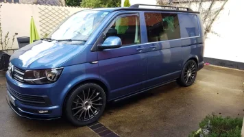

JP's tyres are 630kg on fronts !!! Most of them are when doing that many mods air ride on 275/40/20 would look stupid !!
Min 860kg on t32 103 tyre
Lots of people will see this months VWt magazine.. love the vossen wheels on front cover, buy them without knowing they are not suitable for T32 weight..

Yeah, I had a bit of an email chat with Rimstyle and they confirmed that their search engine does factor in the load rating of wheels and permitted axle loads, so I think you are right @blindboy....they must be under rated for a T32 :(
