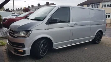

Heres a T32 EOM sportline . . .

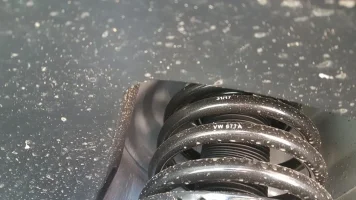

These are the springs from factory :

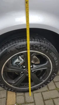

the clearance measurement empty:
the rear empty:
front empty:
and the final result with the weight added for normal day use.
I'm aiming for H&R ARB anyway but just wonder if the updated springs would be necessary? Or suggested.
