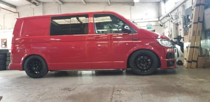

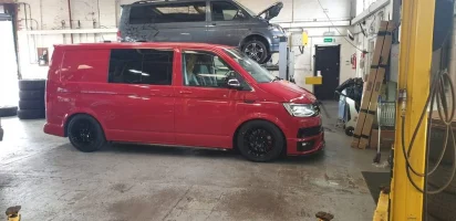

SoLow by Bilstein
5mm left on the thread on the rear and about 10mm till bottom of thread on the front.
Mines only on sportline 18s just a bit gutted it’s not lower. Guess I’m used too airride
You can get these seriously low if you want to. Remove the rear adjusters and fit some machined top mounts at the front and it’ll be about 20-25mm lower than @Jayjmac pictures.
You have to be careful with wheel and tyre choices when you’re that low, but being used to air I’m assuming you would know that already.
