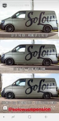

SoLow by Bilstein
@T6180 how you finding the front tyre wear? When I have my extremes wound down the camber changes enough to scrub the inside edges out... I can’t get the 4 wheel alignment done either because there’s not enough arch gap to fit the gauges on.
tyre wear has been fine so far no issues at all touch wood
I’m now wondering if, even out of the box at maximum height, they’ll be too low for a camper conversion with an ABT front splitter.
Looks great.
I really want to buy these, but I am still awaiting a few more reviews to come on the forum.
Could you tell me if the ride is comfortable ? ( I had b14’s on my last van and I found them quite a harsh ride)
Are you getting any rubbing on the front and have you had any arch liner mods done ?
So far so good it’s totally transformed the van. No rubbing but I’ve not really drove it to be fair, I’m definitely going to lift it about 10mm and it’s just a tad to low. As for arch mods I’ve not done anything
