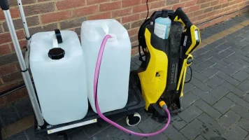

and again K7 + 2x 25ltr Tanks . . . .

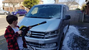

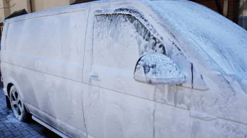

all mixed up in the Snow-Gun and after a full jet-wash - Liberally applied =]
I just love this stuff - spraying it on just seems so pleasing . . . . .

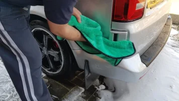

apply Srint spray wax stuff,
towel dry.
Total time = 45mins
this time i got some extra free labor as well . . . . . .

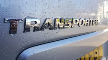

So how did it turn out thgis time????
Well . . . . . Very shiney
