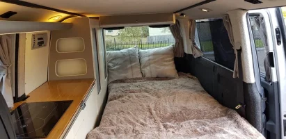

That is a SWEET job!! I don't suppose you filmed or photographed how you ran the ducting, what ducting you used and how you created the side vents?
The ducting and vents went in when I had the roof installed, so it wasn't me personally, that did this part of the build. However, when I've gone on to run some wiring and fit the rear overhead locker, I was able to see how it's been done. Two duct tubes run from from the top or the rear heater box up the rear right D pillar. One then heads forward along the roof to the right overhead vent. The seconds goes across the roof just in front of the tailgate before heading along the left hand side. Its a bit tight though as a thick wiring loom runs along the side of the roof too. Here's a pic of the components and where to source them. Just double check your outlets to ensure you get the correct diameter ducting. There is a low level outlet from the heater box for floor heating too. Sorry, I don't have any photo's of the ducting in place.
This photo shows the location of the roof vents. The black squares you can see just forward of the C pillars.
If you have 3 zone climatronic, worth noting the rear control panel needs to be plugged into its connector on the loom. If its left unplugged you lose control of the rear heater box from the heater controls in the cab.
My rear heater controller is now fitted to a side panel with an extension made to the wiring loom. However you could leave it plugged in but hidden somewhere if need be. May also be possible to put a jumper across two pins on the connector, to fool the heater controller into thinking the rear controller is plugged in. However, I haven't tried this in practice. So I stress 'may' be possible.

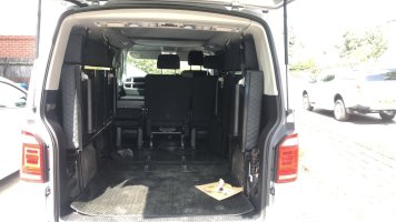

I'm hoping for some advice and a few photos. I've got a 6.1 shuttle and I'm going to get a stealth roof fitted.
Plan is to get rid of most of the shuttle trim, fit van shades and keep the 3 single seats. Then back for bikes.
I think I need to keep the headlining as it has curtain airbags but the challenge is making a nice job of the b and c pillars and the roof. So any photos of these trims would be great
