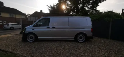

I liked my 20s, but 19s seem to be my sweet spot. Although I'm looking forward to getting my banded 17s back on once I get a pair of 9.5s to swap out the 10s at the rear.

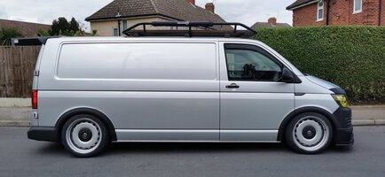

I went staggered and 20s for the moment. With a slightly different 35 8.5 front and 40 on a 10 rear.

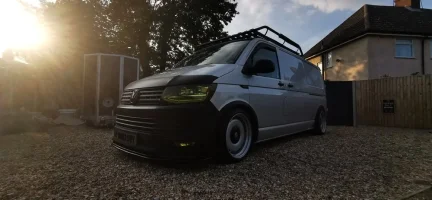

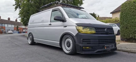

I'm running 19's and I have found that sweet spot after great expense.
The secret recipe:
30m Drop
19x8.5 ET45 all round.
Running 104 rated 255/45/19
Giving this as a look if it suits you.
The van never bottoms out, and it never rubs or catches.
I have gone across a field with no issues.
It's planted at speeds, yet very comfortable.
Laymen's terms it's 2 fingers between the tyre and arch at the front, and 3 at the back, giving tolerance for any extra weight in the rear if needed.
(oh and I don't have huge sausage fingers)

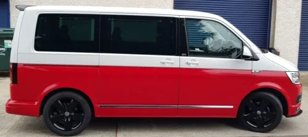

I have TSW MAX alloys 19" matt black , tyres Nexen 255/45ZR19 104Y . The only thing with 19's is not much tyre choice . TSW also do different style alloys in 19 " and matt black . I got mine from rimstyle.com hope this helps .
