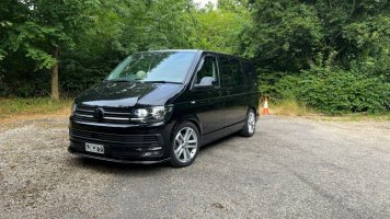

That looks spot on! What size tyres are they. I’ll go and check out the spec on the wheels. what drop have you got there? About 50mm ish?
They 255/45/R19 Eagle F1’s all round, put a 15mm spacer on the rears I think as they were tucked in a bit too much. Not sure on the drop as height adjustable, the fronts are not far off fully wound down.
Can I be a pain and ask for a measurement - you’re slightly higher than mine but the arch fitment looks spot on
