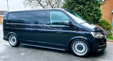

If i've read correctly, you're asking what banded 19's running 255/45/19s, on B14's set on lowest on a T32 are like in the real world.
It just so happens that's my exact set-up.
I travel up and down the country every day, sometimes covering several thousand miles a month.
In the real world they are fine. Yes it's a hard ride if you're not on a Motorway, and yeah, you'd be advised to dodge potholes if you have fillings in your teeth, but i've been running mine for about 20k now, and other than smashing into a couple of potholes and bending 2 wheels, which were swiftly repaired by Duchy steels, they are fantastic set-up.
I often ponder on the Swamper look for several reasons, but if I ever do change over to this style, I will miss most of all, the way my set-up handles. I'm not adverse to throwing my T6 around, and the way it glues to the road is nothing short of mind blowing. This in part is down to my tyres. and suspension set-up, but it's one of the best things about my T6.
So to answer your question, yes they work perfectly if you don't mind being careful, but no more careful than you'd be with nice alloys.
Edit: To answer the PM you just sent me. I'm literally on as low as the B14's will go, and I get no rubbing at all, other than a slight catch on full lock as I reverse off my drive, but you'd struggle to notice it.

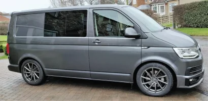

Not going to work as they are touching the door already with 245/35/19 on... had 10j Et40 on my T5 with 10mm spacer.. these BBS are on 19x9.5 Et35 and are touching the door... bloody Velle Door cards
I have Amarok 19" rims with 275/40 R19 tyres plus spacers and works perfectly on my Caravelle.
But yes it is tight, only few mm clearance.
