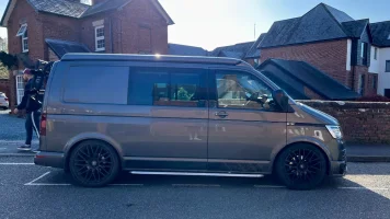

Hi all,
I currently have 20" Momo alloys on my T6 camper (photo below), lowered on SoLow NSL's and the combination of this and the state of local roads means Im looking to 'downsize' to a 17" alloy, but are unsure of tyre size to go with?
I've seen Navis MAC AT's, with 225 to 245 width options, with 55 to 65 tyre profile...
When the van was a kombi, the alloys worked. But the weight of the conversion is just ruining the ride in my opinion...
Any advice would be greatly appreciated!
