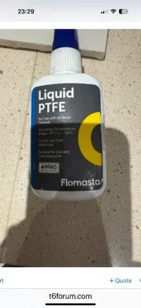

For roof rail, roof rack etc fitting that bolts into the existing roof mount threads I would simply use a good quality rubber spacer, or flat seal to suit your application and use some good quality liquid PTFE.
I rate this stuff. I use it on LP water and in a few minutes it forms a W/T seal. I used this on my roof rack bolts along with supplied ‘rubber pad’ from ARB and no issue. Also used it on other friends VW roof blank bolts as a precaution and 18 months later they too say previously leaking bolts now cured.
