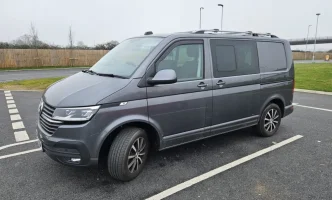

Inspired by this thread, I decided to fit my roof rails as well.
All metal parts are stainless steel
I tested various combinations on a drilled bucket with half a liter of the water. No leaks after few days :)
Stainless steal rods fitter with loctite 246 (blue one)
My "bucket test" said the best combinations are EPMD bonded washers + flanged nyloc nuts.
In order to sleep better also used chassis wax (just in case) to prevent potential leaks.
Fitted roof rails and roof bars as well. VW looks much better right now :)
What really surprised me - It's not significantly noisier :)
