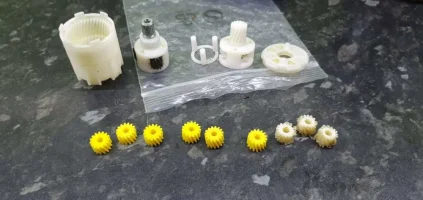

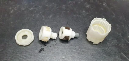

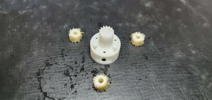

If anybody is curious what's inside OEM electric drive, have a look below.
