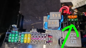

Unfortunately when you have the powered tailgate it's not an additional module to the soft close but a whole new all in module. I had hoped to be able to put a switch in to just disable the powered element but it seems the only option is to disable everything, powered open and close, soft close and (I think) the electric latch release.
So far I have tested this by pulling the 30amp fuse. This certainly works but I haven't yet risked seeing what happens if the tailgate is mechanically latched or turned the ignition on. It's a bit tricky as the fuse is one of those with additional clips at the side to hold it in.
So my plan at the minute is to intercept that power line either at the fuse or the harness coupling block and switch it so I can make the tailgate safe when needed.
I plan to just depin the fuse feed or connection block and make connections in such a way I can quickly return to stock rather than cutting cables
It's a 30amp fused circuit so switches to do this are quite big. Instead I have some spare 646 relays and may use a smaller switch and one of those wired NC so there is only a power draw when disabled.

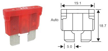

I would go with standard blades rather than try to split fuse taps or fuses. But the blade should be closer to 5mm

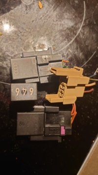

I've also got hold of some 646 relays in the same bases that should clip into the spare ways in my seat base fuse carrier

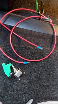

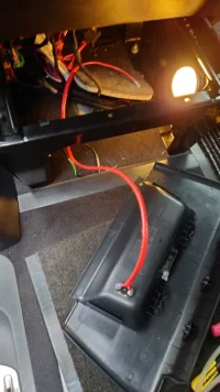

So finally got around to at least MK1 of a solution as our big roadtrip is coming up.
Rather than a relay I found one of these from a previous project. It's a high current toggle switch with a safety cover. Normally it's designed so that you lift the cover and turn it on, then a quick push of the cover flicks it off. I want it to work the other way around so I turn the tailgate module off and it's normally on.
There's a little tab on the cover that engages with the switch so I had to Dremel that flush to use it the wrong way around.

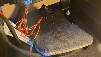

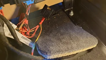

I then used some salvaged from an eBay Golf fuse box repair wires to populate the empty fuse holder next to the one with the 30A fuse in.
One loops up to tap into the existing fuse position with a standard spade terminal, it's a fraction wider than a fuse blade but there is plenty of space. The other one is but crimped to a wire that runs to the back of the seat base and back. The return wire ends in a spade terminal back into the original fuse position.
The switch is screw terminal not spade sadly. So I terminated in a small ring crimp. When on I'll use some heatshrink over the whole terminal and screw to ensure nothing comes loose or shorts
I then drilled a spare seat base back I had found on eBay with a step drill, secured the switch and cover, tightened the screws and heat shrinked. Annoyingly I couldn't find my roll of cloth tape so I had to loom the two wires with normal tape.
Some fettling of the cable run and get everything back in place and the final result is quite pleasing. The switch is tucked well into the recess and it's unlikely to get knocked and the cover protects it. But when we park up and have the tailgate up and kitchen deployed I can now flip the cover and switch up to disable the tailgate power with the ignition off like this:
Then when pack away the kitchen and rain guards I can flip the cover down and repower the tailgate.
Interestingly it closes with a rapid beeping very different from the normal warning. However once closed normal behaviour is returned.
I've not risked turning the ignition on with the tailgate disabled and I'm going to try and avoid that.
