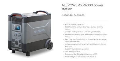

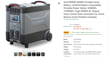

ALLPOWERS new 4000W,3600Wh beast :
ALLPOWERS R4000 power station​
20% OFF Offer! Now £2799.67
View attachment 185250View attachment 185253View attachment 185252View attachment 185251
General Info​
Net weight:
Approximately 45KG (99lbs)
Size:
540*490*300mm ( 21.25*19.29*11.81in )
Battery capacity:
3600wh 48V
Wi-Fi:
Supported
Bluetooth:
Supported
UPS (uninterruptible power supply):
Supported
Input Ports​
AC Input Voltage:
100V 15A / 110-120V 12.5A / 220-240V 10A(Max.) 50Hz/60Hz
Solar Charge:
12 -150V MPPT 40A Max, 2000W Max
Car Charger:
Supports 12V/24V
AC Charging + Solar Charge:
4000W Max
EV Charging Station + Solar Charge:
4000W Max
Output Ports​
AC output (*4):
Pure Sine Wave
100V-120V 3600W (peak 6000W);
220V-240V 4000W (peak 6000W);
USB-A (*2):
5V2.4A 12W
USB-A Fast charge (*2):
5V2.4A, 9V2A; 12V1.5A 18W
USB-C (*2): 5/9/12/15/20V 5A;
100W Max per port, total 200W
Car cigarette output:
12V-10A, 120W Max
RV output:
100V-120V 3000W; 220V-240V 3000W;
Battery Info​
Battery type:
LFP Lithium Iron Phosphate
Cycle life:
3500 cycles to 80%+ capacity
Protection type:
High temperature protection, Low temperature protection, Over discharge protection, Over charge protection, Overload protection, Short circuit protection, Over current protection
45kg wow.

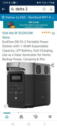

Has anyone got/tried the Ecoflow River 2 Pro? It's back in stock and I'm thinking I could save £350 buying one of these rather than the Delta 2...
I've got the EF River 2.
Not the Pro version.
Basically the same unit, just smaller.
Thanks Lee. I’m confident the Pro unit will do all I need a portable unit to do. We’re not doing long trips off grid. I have a leisure electrics install for when I am on an EHU to recharge everything and solar. The money I save buying the Pro over the Delta 2 might in time go towards a portable solar panel.
