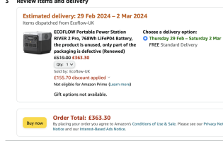

I've just ordered 2x Ecoflow River 2 Pro - cos they are available refurbished on amazon at £363 each (with a 30% off voucher) just seemed ridiculously low price and I figured I get 50% more juice for the same price I would have paid for the delta 2. (The delta 2 is also available at £609) Hope there is nothing wrong with it. Search for renewed and make sure you redeem the voucher.

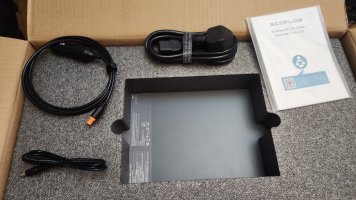

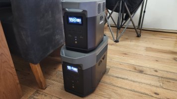

Say hello to the latest family member.....

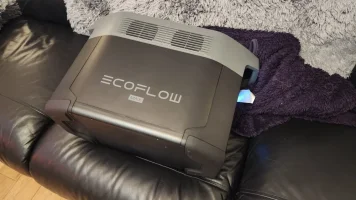

EF Delta2 Max
The bigger brother to the Delta2.
2400w/3100w and 2048wh

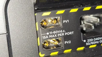

Now with twin DC inputs and 2400w mains charge.
Plus EF have just Beta released a DC-DC charger that can charge up to 800w from the engine bay.... nice !! (Looks like it will work with all Delta units) ( Basically a EF OEM version of the 12-48v step up bost converter, charging the internal 48v battery direct from the side expansion port)
It's a one stop portable EHU shop, where as the Delta2 was a bit short in capacity at 1024wh, allowing 80% of that. It was a bit to short for a weekend.
The Delta2 MAX now doubles the capacity to 2048wh and bumps the inverter size a bit too....
Roll on the next camp out for a test....
With twin DC inputs for solar or dc-dc up to 1000w this should allow me to run my Chico 700w heater in the van off grid, as well as the kettle, coffee machine, fridges etc etc..... if if I run out of juice a quick plug in to EHU will see me charging at 10A from the post or up to 2400w.... Now that's FAST!

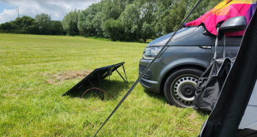

First proper weekend out with the EF Delta2 Max. . .
Get a Discount !!!
this was the setup. . .

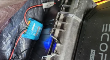

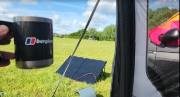

200w Renogy solar suitcase, on a 75/15 victron,
which at one point gave us the full 200w !!!
that was feeding the @RoamerBatteries SB230 in the battery box.
which was being used a buffer battery for the Delta2 MAX. (trickle charging in @ 100w)
nice. . .

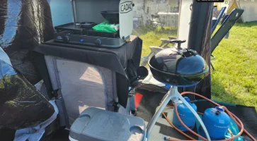

this setup enabled us to run the two Dometic compressor fridges for the 5days trip.
we had the CADACs and Gas for cooking,
but also had the 1400w coffee machine, 1000w kettle and 500w milk frother on the go. . . . . .
which was nice. . . .
whole setup had us running for the full 5 days,
by this point the Roamer battery was low at 5%, but the EF D2M was still at 50% - so we made it without running out. ( a mix of a few sunny days and a few cloudy days)

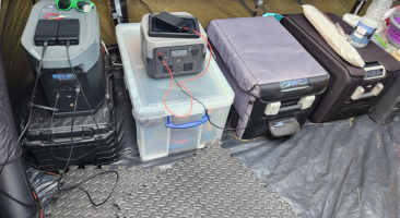

and for the keen eyed,
we we also had the EF River2,
that was mainly to pass around the camp for other people to charge battery packs and phones etc. . .
we charged at home,
and it never run out. . . . so happy days.

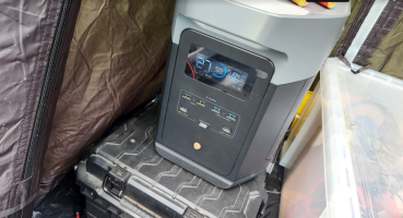

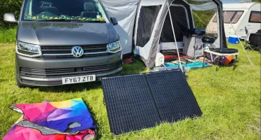

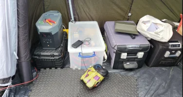

View attachment 243301View attachment 243308
View attachment 243302View attachment 243309
View attachment 243304View attachment 243305
nice. . .
View attachment 243312View attachment 243313
we charged at home,
View attachment 243316View attachment 243317

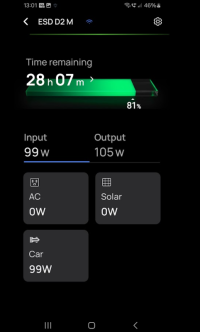

just noticed a major benefit of my cable -- 160W charge Rate from 12v --
double sweet . . .
charging and testing all the gear for T6F summer camp..
and polaying with the settings. . .
On the ECOFLOW units you can set the INPUT as car/solar/auto.
in CAR & AUTO setting ( assuming below 15v ) it sets the current limiter - 2/4/6/8A input max - so 100w
BUT
, when you set the INPUT to SOLAR it removes the Limiter . . . so woosh, max power from my battery box.
look 160W in from the 12v batteyr box.
with the EF input DC mode set to SOLAR.
this is confirmed looking at the Poweroad Lifpo4 battery BMS. . .
shows 13.0v
with the CAR setting you can see its limiting to 8A into the EF.
but with the SOLAR setting the limiter is removed and were getting 13.3A in.
which is now giving us 160W input charge power from out 12v lithium storage box.
Nice...

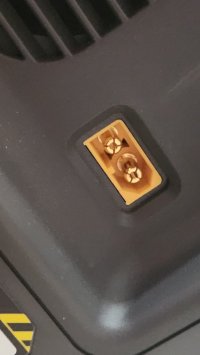

How are you getting to the DC Mode screen?
Can't see it on the EFD2
I can change the car input 4/6/8A but can't select solar/auto?
Perhaps I need to connect something to it to change the setting. Currently there's no input.
Ah. That's form the EF River 2.
Which has the standard XT60 connector.. (and the option in the menu)
The EF D2 and D2-Max use the XT60-i conector.. which has a third center pin.
This pin is wired in a way that tells the unit if the cable is for a CAR connection, or SOLAR connection.
So you need to buy the car or solar connection cable.
Car is limited to 8A, and Solar allows the higher voltage.
