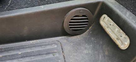

Do you have an air intake in the drivers footwell step?

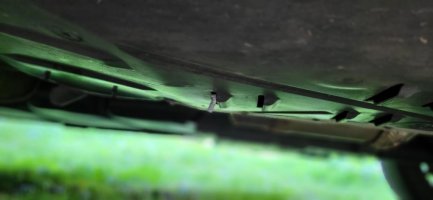

Thanks again - here are some more pictures. Having looked underneath I see there is a 6mm bolt hanging out of the tray. So perhaps something has come to bits in there!

Oh - and by the way - is that footwell light supposed to have a cover on it?

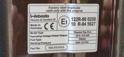

You have a Russian Planar mounted underneath and also a Webasto coolant heater.
You will have to peruse the Planar manuals for hints on faults.

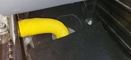

The controller is the PU27 for an Autoterm Planar Heater. It could be that the ducting has come off the heater outlet but you will have to drop a tray to find out.
Yes the light should have a cover.
Oh - intriguing? Two heaters? what is the coolant heater for? Is that something that VW fitted or was it part of the camper conversion? sorry for being dim!

The PU27 controller is fairly basic but if you are not getting any error codes then I would look at the ducting connections first.
You’re looking for a Caravelle step-light cover
I've not one myself but understand it to be a factory-fitted pre-heater that will last 120mins max.
