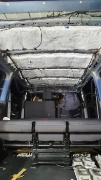

I purchased a 2018 LWB SE shuttle a couple of months ago and began modifying it straight away. We have always dreamed of having a van so basically sold my motorbikes and purchased this shuttle from Scotland. Drove my car up there traded it in and drove this home. 4 hours after collecting it I was getting a MFSW fitted.
Next on the list was sound proofing it and insulating it which has caused alot of bleeding (2mm Silent coat is a bastid!!) and running the wiring for EHU and leisure battery. Big thanks @travelvolts for his wiring kit.

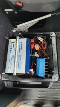

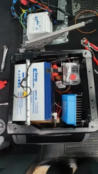

I have installed a exp + 130 AGM under the drivers seat connected to a Victron orion-Tr smart charger. Its a very tight fit and I need to make good on the oem loom so it doesnt get near the cooling fins on the Orion.
