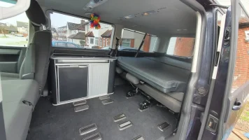

Along with the bed, do you know if that pod will allow you to classify the van as a camper if you want to? Looks like a great unit with all the basics including a proper fridge, did you have to wait long to order it?
I have a pod (altho slightly different to that one as my pod is about half the size and my fridge is not part of the pod) in mine and its DVLA classified as a camper, Altho it was classified before they got tough with all the sticker and pop top requirements.

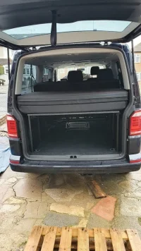

I want to carry two bikes in mine also. Looks like you have to remove both wheels to get them under there? Do you find the frames get scratched at all?
Nice set up :)
Its not ideal to be fair, theres only actually my bike and my sons 20" in there and its a squeze, have to thread it under the rear seats. if i go away without the lad I turf out all the middle seats and put them upside down in the middle and use the floor clips to strap them down.
My van-king bed arrived yesterday, got it fitted asap and then slept in the van last night. Lovely bit of kit.
Two things I didnt realise when purchasing the bed were 1. The headrests need to be installed to support the feet end of the mattress. 2. The table that slides out is the support that you sleep on.

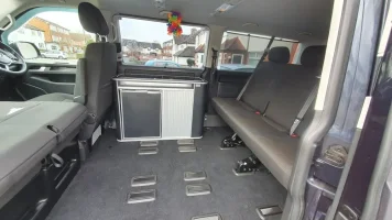

Fitted vangear pod unit. You can see theres just enough room for someone to sit behind the unit, the van-king bed also fits.
Absolute bastid to secure the unit to the seat plates using a J hook !!! I need to find another way to do it...
Looks really good. Could you create another carpeted ply base under the van gear unit (appropriately fixed together) and then bolt that down to the factory lashing points...
Thats a good idea, I will look into that. My next job is to create a large pull out drawer under the van-king bed so will have left over wood from that :)
