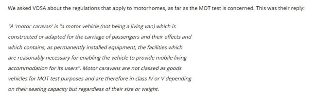

See the statement from VOSA included in the motor homes link on my post. The tester has to test the vehicle “as presented”.MH MOT.JPG
