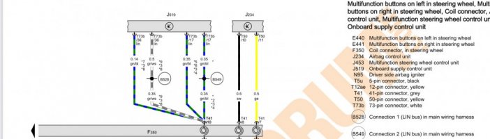

from what I've found out is Steering wheel connector I run cables from pin 9 & pin 10
These then connect to the light switch 12 volt and the BCM pin 17 or pin 36
then I just need to find someone to code it
Sounds about right. Pin 17/36 is dependant upon whether you have euro 5 or euro 6 engine iirc.

Power is usually taken from the switched live behind the light switch
Ready to connect the cable to the bcm pin 17 do I have to take the connector apart to find pin 17 or can find out what colar the cable is and just connect from there
Have a look at the MFSW wiring diagrams in the downloads section. You’ll get the cable colour from there
Ok just to throw my tuppence in to this great thread, has anyone put paddles on a T6.1 dsg yet (yes it does have acc)? Just got back from a trip accross from essex to Pembrokeshire and found myself flicking the invisible paddles. I had them on my previous range rover and used them regularly. I tried using manual shift on the stick but was a waste of time. Now my hands feel like something is missing. I guess its like a smoker that has to chew a pencil to replace the cigarette. I would like to add paddles but as my van is still warranted, I do not want to jeopardise it. Any thoughts please? Thanks.
J519 is the BCM, T73b/17 is pin 17 in the white plug. Wire is green/blue

Totally stuck mfsw all wiring connected
Steering wheel connector wires added to pin 9 & 10 connected to the blue/green cable on the bcm and 12 volt from the light switch.
Nothing working on the wheel would of thought the buttons would of at least illuminated though the light switch
Van is a euro 6 so bcm connection is correct
Any help anyone getting to the point of refitting my old wheel and selling the new one (wheel was bought from t5upgrades so I know it fits
