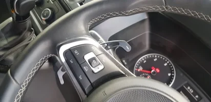

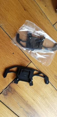

Do the DSG Paddles work?
did they do the PIC chip in just one side of the buttons or both sides?
Poole or Christchurch branch?
Paddles work straight away, no coding required. :cool:

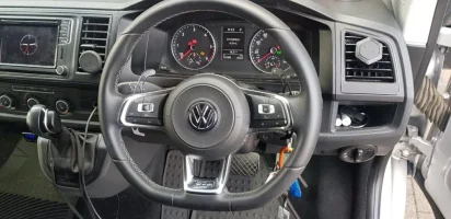

so after sending the guys my G-MK7 MFSW and having the work done . . . . . it was back and ready to be fitted...

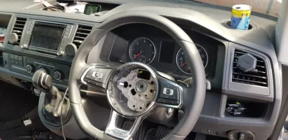

First things first - disconnected the battery and "capacitive discharge" the leads.

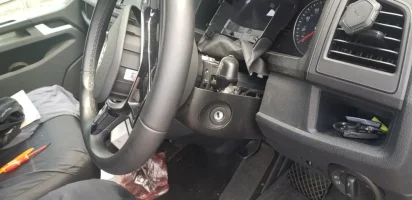

now all was safe its time to carefully remove the upper cowling behind the steering wheel . . .
with the wheel at 90degress we can now gain access to the spring clips on the rear of the airbag . .
turning the wheel 180deg and popping the other airbag clip had the airbag released...

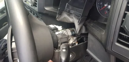

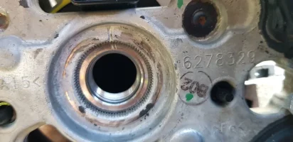

Now we needed a "M12 spline bit" for the center mounting bolt . . . (which i didn't have!)
so a quick google gave me this . . . . Toolstation @ £17
once the center bolt was removed we need to mark the center-line of the wheel and the steering column. . . . by scoring a line with a stanley blade.
that done it was easy swap . . . . . . or so i thought,....
after fitting the wheel and a quick test we had a load of errors . . . . .the horn didn't work and all the ACC and CC functions were disabled due to errors that could not be cleared down with Carista or VCDS!!!

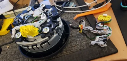

The old and new loom were swapped . . . (and yes there some differences, the MK7 had an extra blue wire and pinned in different locations on the main plug)
but the looms swapped over ok..>> Now for another test . . . .
Fitting the New Airbag with old loom back in we put it all back together and re-connected the battery . . . . . . to my joy NO-ERRORs !! - so far...

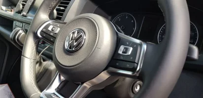

next was a test drive . . . . . . and happily all the functions worked . . . . Flappy paddles too =]
so very happy with that . . .

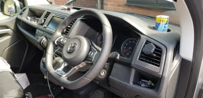

so all in all its fitted and working . . .

one interesting thing to note is that the T6 MFSW has red back-lit buttons . . . .but the MK7 MFSW has white back-lit buttons . . .
ill try and get some night shots to see what this looks like.
But for now . . . . . . thats another job ticked off the list.
